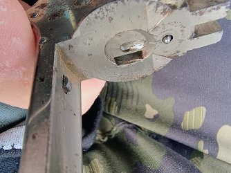

I have an old s&w 1 1/2 32s&w.
All is completely solid lockup timing etc. I noticed the firing pin will not protrude and make it to a primer. Seems that the hammer won't fall all the way.
I noticed the mainspring tensioner screw is all the way in. Is there too much tension on the spring possibly? The screw is frozen in place and it will not budge whatsoever.
If I hold down the trigger and push the hammer forwards it will seat all the way.
I will post a picture of my thumb pushing the hammer forwards and one with the hammer not down fully.

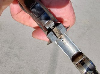

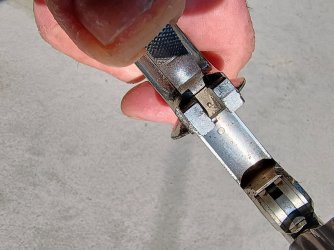

Will do. The pin will protrude past the recoil shield if I push the hammer forward with the trigger depressed. Otherwise it won't make it,it would never fire a round .... 😭

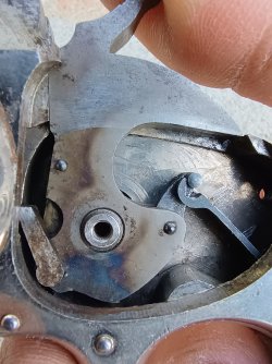

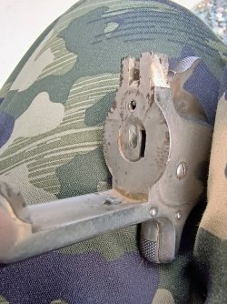

So I decided to take the side plate off. With the hammer all the way forward I noticed that the two prongs at the end of the main spring are no longer in contact with anything the hammer almost comes off of it. Wondering if there's too much tension on the spring
Here is a photo under the hood.
Hammer resting and seated fully with firing pin protruding. - notice how the mainspring lost complete contact with hammer down, hammer won't fall. I have to push it into position.
Photo in number 2 shows hammer rearwards at full cock position.
Action is solid. Lockup and timing perfect.

Hi There,
You have a S&W .32 CF SA and most of these have what is called a "reboun-
ding hammer." The hammer will rebound a short distance after firing the
cartridge. When the trigger is released, it blocks the forward travel of the
hammer. This is the built in safety these were made with and your revolver
is working normally.

Hey Webb,
You just made my night 😆.
I never thought but if I put my finger over the recoil shield where the firing pin comes out and pull the trigger I can feel it. How strange I didn't think to think of that.
Your revolver is probably fine. I have several of its brothers, and I've shot them all. The mainspring not fully engaging the hammer stirrup would be a sign of not enough hammer spring tension, NOT too much. The very early ones (I have one) had a cam screw under the grips to adjust mainspring tension. The majority have a standard, front of grip frame strain screw like the ones that exist today. It's possible that someone shortened the end of the screw in an attempt to get a lighter trigger pull. Never a good idea. The screw wasn't meant to be adjustable. It was meant to be screwed in all the way. If it turns out that your strain screw has been shortened, you can just put a shim between the tip of the screw and the mainspring to make up the difference.
