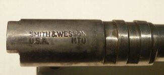

I asked about the S&W manufactured barrel shown below a few years ago. So I'll be watching this tread with interest.
The barrel shown is marked "USA" and "MTU". These are acronyms for United States Army and Marksmanship Training Unit. MTU gunsmiths produced some of the most highly developed target pistols ever seen. I suspect that S&W may have had a contract for some highly precise barrels for that use.

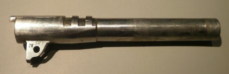

Resurrecting this thread with a answer since I received a CMP 1911 today with a S&W replacement barrel. The chrome lining nearly blinded me when I shined a flashlight in it to check the bore. It is marked SW on the side of the lug and the numbers are as pictured.
