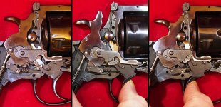

Question: It seems to me, the Taurus trigger return spring is not only a better idea than the S&W rebound slide, but has far less friction and is much easier to work on.

I examined a T brand 44 spcl snub to find it required a working transfer bar to complete hammer action to the fire pin. A tiny, tiny stud sideways out from another part raised said transfer device. It looked frail and breakable. I researched and could not fide a replacement. Seemingly a S&W will still fire if the hammer block fails to engage.

Taurus revolver action better than that of S&W? I don't know that I would go so far as to say it's better, but it is very different from that of the S&W.
Bear in mind that Taurus copies many design elements from the S&W lockwork, but uses a transfer bar mechanism, and not a rebounding hammer. Thus they have no need for a rebound and can have just a trigger return spring. The S&W rebound slide both serves as a trigger return as well as automatically lifting the hammer and hammer nose away from the cartridge. The rebound slide mechanism was quite an invention around 1902, but other methods have been invented since.

Very interesting, and I had not thought of that. I've done amateur gunsmithing on both for over 35 years, and, while the Taurus is an easier gun to work on, I find the S&W quality of parts better.
