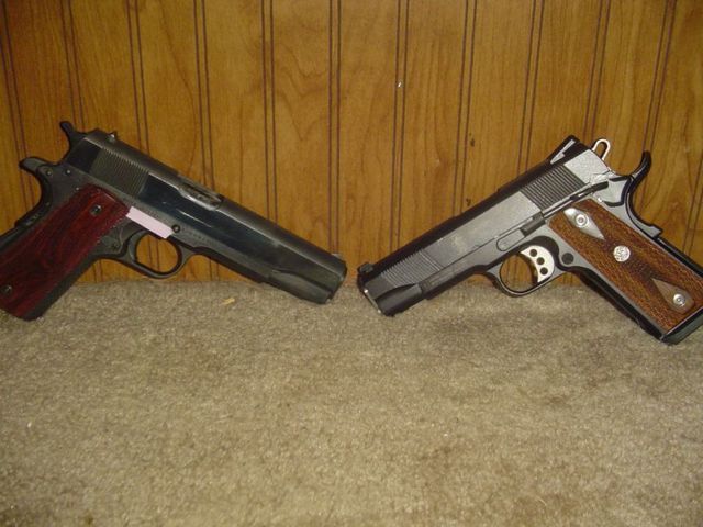

I have a Colt light weight commander and a S&W E series bobtail. The S&W to me is a better shooter than the Colt hands down. I personally like the fish scales and the 2 tone finish. I also have another Commander series 70 brushed nickel If I could have just one of them it would be the Smith
