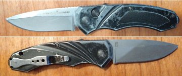

I have a Schrade "Extreme Survival" Taiwan blade automatic. I may have had it 15 years or so. I think the blade was 2 3/4" before I sharpened it a bazillion times. Calling it an "Extreme Survival" anything is a joke. But for everyday carry it was the perfect size for me. It was made before everybody got sued for using a blade lock method that I think BenchMade held the patent for. Mine has the lock.
Anyhow, the spring broke. I pulled the spring and measured the OD at .480". I couldn't find that size anywhere. I guess it's possible it started life at .5" but I don't know.
So I called Schrade to see if they had a spring for it. I was advised that they don't sell parts or repair knives. They just replace them. I told them that my knife wasn't a high doller knife and was fairly old. They then told me they had a lifetime warranty. That I didn't know.
They asked what I wanted that was comparable and to send pictures of mine. So I sent picture of my disassembeled knife showing the broken spring. As far as I can tell there is nothing comparable in their current lineup. I told them I'd prefer another automatic but an assisted opener would be OK if it had a blade lock. The blade lock is key as I don't like knives opening in my pocket. They said they would see what they could do.
Well a day or so later I got a robo type email saying they would replace the knife with a comparable model. I said yeah sure, and didn't expect much. A week later I got a knife in the mail. It was a better quality knife but an assisted opener without a lock to keep it closed. I was still fairly satisfied but didn't open the retail package and figured I'd gift it. For me no lock is a no go!
So I figured what the heck. I'll go back and try fixing my old one. I torched the broken end of the spring and made a new hook for it. I quenched the torched end in oil but I know the temper is toast. I don't think there is any way to temper just the bent end on such a small spring. I'm sure you have to do the whole spring. But I did what I did. It originally broke because, due to internal friction, a good third of coil just wore too thin until it just gave out.
I put my knife back together and it works. I don't know how long the spring will last. It seems to slam open a bit harder but it did lose at least half of a coil. We'll see how long it lasts. But for now it's back in business. It's lasted over a week so far.
Well yeterday, another package showed up. In it was a much higher quality Schrade automatic. Made in America. It doesn't have the glass breaker my other one has but it's a very nice knife, at least it is in my book.
This one I'm afraid to use because I'm a knife abuser. It seems a shame to treat such a well made knife to the life it will have with me because it will get used and abused. I don't abuse them on purpose, but I do. What to do... Well I do have my old one working for now so I can think about it for awhile. I suppose I should get a .5" spring to try when my repair fails.
I guess I should send one of the knives back as I'm sure they didn't mean to send me two. I guess the takeaway from this is that while Schrade doesn't repair knives, they do otherwise have very good customer service and they stand behind their products.
