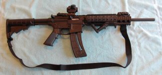

So I have a scope riser with these specifications
1 inch saddle height ; measures 5.7 by 1.75 by 1.2 inches (L x W x H)
I am curious as to the pros and cons of having the riser as opposed to not having it on there. Aesthetically, I feel it makes my rifle look boxy and a little chunky, but if there is a more functionality to it, then I will keep it on.
I don't have any irons on the rifle to co-witness with my scope/red dot.
The optics I have are a UTG 6.4-Inch ITA Red/Green Dot Sight with Integral QD Mount and a UAG QD 3-9x40 scope.
Well the riser came as a set with both the red dot and the scope. I just put it on thinking I needed it. I'm a new shooter and I've been more of a handgun shooter and the 15-22 is my first venture into rifle shooting. I don't quite know as to why it should or should not be used in the first place.

Thanks guys! I just came back from the range after just mounting the optics on the actual rail instead of the riser. I was blowing out the bullseyes at 35yds with no real effort. The riser is a nice piece of kit and maybe when I get flip ups, I'll put it back on but until then, WOW. It made a huge difference.

I think the UTG riser was about $8 at Amazon with free 2 day shipping (Prime). 3/4" rise for absolute co-witness. Magpul BUS, so if Red-Dot fails, quick pop it off and use iron sights and everything is in alignment.

In addition to raising the optic up to a more natural position for me, I used a riser for my scope to allow it to clear the rear MBUS and for easy removal so I can use the irons or mount up an RDS w/o out losing zero on it.
I kinda like the way it looks as well.
