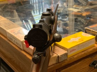

I don't have an 8400, but I do have an 84M (.260 Rem) and an older Kimber of Oregon 89BGR Super Grade (.338 Win). The issue isn't so much objective housing clearance, but clearance of the bolt knob. Lens caps exacerbate the problem. You also need to worry about ring spacing and proper eye relief.
IMO, 4-16X is way too much scope on a .300 Mag hunting rifle. You also want to keep overall weight at a minimum, especially when hunting at elevation and walking up and down hills. I wouldn't go any higher than 3.5-10X and lower magnification is superior for close shots on moving game.
I have Leupold rings and bases on my 84M and mounted a VX-III 1.5-5". As can see from the photos, the bolt knob barely clears low rings and this is only a 1" main tube scope.
