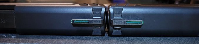

Ok, so, I did some comparing. The frames seem to be the same dimensions other than the inside of the mag well. The slides measure about .010" wider on the 40 slide in some locations along the length. Just for fun, I swapped slides with frames and they fit perfect and bench functioned fine.
Rosewood
