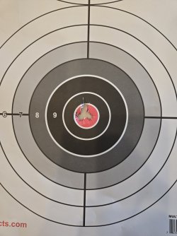

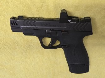

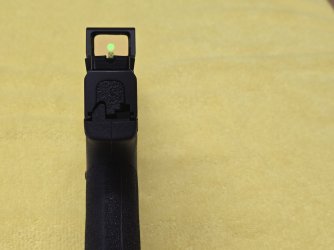

I've got a CT RAD Micro green dot on my Shield Plus Carry Comp. It's a direct mount, no plate required, comes with correct screws, co-witnesses, and won't break the bank (got it for $139 on Amazon). The target pic is the zero at 7 yards (supported).
