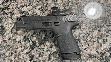

Crimson Trace optics will mount directly to your Shield Plus, no plate required. I know the optic snobs turn their noses up at CT’s but I’ve got four on different guns and I'm very happy with them. They co-witness, hold their zero, have a long battery life and shoot just as accurately as more expensive brands.
My favorite on a Plus is the CT RAD Micro Green dot – paid $139 from Amazon.

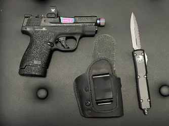

I would caution against removing the posts on the optic location. Once they are gone, they are gone forever, and it may void the warranty. I put a Holosun 407K on my Shield Plus and had to use a plate to anchor the optic and a shim to get the elevation correct. Knowing then what I know now, I would have gone with a Vortex Defender or Swampfox for a direct mount.
Having said that, I've had no issues or problems with this setup; it zeroed and has held zero ever since.

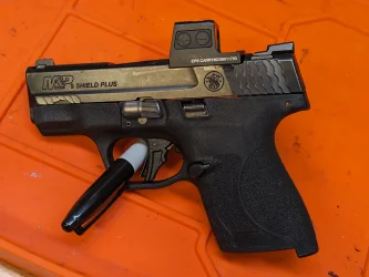

I couldn't get my EPS Carry zeroed on my RMSc cut Shield Plus because mine had a negative slope to the optics cut. You could see quite a light gap between the slide and an adapter plate.
I sent it to Nameless Armament to get the cut modified to Holosun K and the pocket leveled.
I regret nothing.
Before and after pics.
    728.9 KB
    438.6 KB
