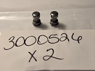

I'm looking for help identifying this striker block. It appears to have a profile that is different from the factory striker blocks I've seen. Is it a version of factory, maybe Performance Center, Apex, Overwatch Precision, other? Your help is appreciated.slide.webp
The striker block in your pic looks like the one S&W installs in their performance center guns. The pic below shows two that I got from S&W a while back with their part number.
Apex also has one that is very similar.
Thank you Mike. The pictured striker that I received in my slide came from the factory in my new Shield. I guess I got lucky. I'm thinking about taking it out to polish to smooth out the trigger.
My PC CORE slide came with that one. It seems like it's a "lottery" now for non-PC guns to have that SB.

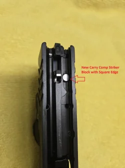

It seems it's a bit of a "lottery" for PC guns now too. My Shield Plus PC Carry Comp (box date 9/5/24) came with a square edge striker block. S&W sent me the two shown in post #2 when I complained about a gritty trigger.
