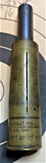

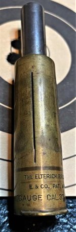

I have such an adapter that is dated 1901. It is chambered in .32-20. Will see if I can find the pictures of it and post them.
