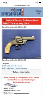

Thank you all for your help. This is one of the examples I saw online that had similar grips. Listing says factory but obviously that could be the seller making a determination.
Is there any other information I could give to help determine more details?
Thanks again!

Active auctions.
You can’t post an active auction according to website rules. Only auctions that have ended.
There is no way to tell on these early ivory grips if they are factory installed without consulting the historical department by obtaining a letter. Factory records will confirm original configuration if they are still available for that serial number.
The odds are against you in this one as factory ivory grips are pretty rare.
