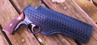

Today I found a new old stock felt lined B49 36 W. Couldn't pass it up for $25. I have many guns that will fit it. That's my K22.
