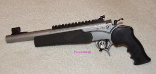

Maybe a moot point, but the chambers in my DW Supermag are pretty good sized
and the fired brass is .01 bigger around than that from my Encore.
It has a minimal chamber that may extend the life of the brass.
If you want a REAL accurate and almost indestructable gun to fire the Max in, consider an Encore.
Bellm, SSK and Bullberry all make good ones.
Bellm specializes in the 357 Max and has barrels in stock.
I quit developing or even shooting much at all out of my DW.
It developed endshake more than once due, I suspect, to the
dinky part that holds the crane in the frame.
And the absurd loads we were using when these first came out
and there was no knowledge base.
You won't believe the velocity you can get out of a closed 12" barrel :)
If you need any other help with the big DW let me know and also consider joining the Dan Wesson Forum.
I have a few documents referring to the Supermags that are getting harder to find.
Nemo

Wow - that's a beautiful 7445 you have there, nemo!
