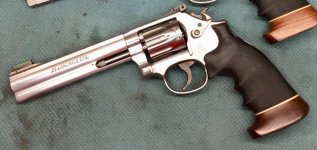

I just got off the phone with Ron Power at Power Custom. He tells me that his firing pin isn't made for the rimfire guns either. He said that the slot that's cut for the retaining pin is in the wrong place and a gunsmith has to cut a new slot for it to work in the 617.
AZ, did you have a gunsmith work on yours when you had the Power Custom firing pin in your gun? I'm just really confused now. :confused:
Gee, I don't know what to say. Mine has just over 500 rounds through it now with no modification to the pin. I didn't realize it needed it.
Randy says to put the factory pin back in and I'll probably end up ordering one now.
I just order 2 new firing pins from Numbrich Arms for the standard 617. I'll switch out when they come in and see if there is any difference.
If it works ok, that's great. That's why I asked. It seems that if you were able to do a drop in installation and it worked ok, then it actually does work. I'll pull the side plate off of mine this weekend and pull the factory pin out. If it's configured the same as the Power Custom pin, which I expect that it is since it's working for you, then I'll order one up.
Thanks for the help again. I appreciate it.
An extended firing pin may make contact with the edge of the chamber. The factory ones generally do not. While I do not generally dry fire rimfire guns, it's nice to know there's no danger if someone drops the hammer on an empty chamber.
I'm not a steel shooter, all my racing revolvers are centerfire. Why do you guys want to use the extended firing pins? If Randy says to use the factory ones, I assume there's no advantage using one with a tuned trigger. Are you seeing an advantage with them?

Initially when I had Randy's first hammer for the 617 he told me to use the extended firing pin because I was getting some failure to fires with the light pull at under 7 pounds. When he gave me the Mass Drive Hammer he told me to put the stock firing pin back in. I got a few failures to fire and put the extended pin in. No more FTFs.
I do have 2 stock pins coming and will switch to see if they work with my heavier pull. If so I will go back to stock firing pins.
