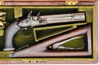

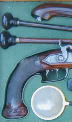

The slot design on the backstrap is an early one found also on early flintlock and cap & ball single shot pistols. This design was more often mated to a wood type extension stock.
The skeletal metallic stocks were more often universal or like Stevens or Frank Wesson were screw and slot mounted.
Photo 1 shows that type of male fitting on a wood stock. This is a very early type design.
I can't really comment on the European wire stock except to say that legit period stocks were not welded. They were cast only.

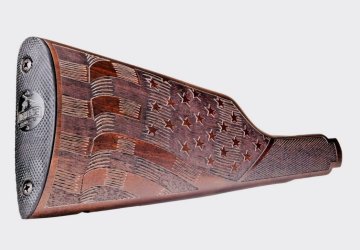

Photo 1.

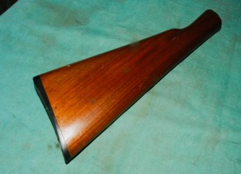

There are also wood blanks for sale out there. Then all you need is a fabricated male key.
Photo 2 & 3
