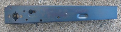

Here are three AK frames. The Flat is considered a piece of sheet metal and not tracked. The bent frame with welded rails is considered complete, but may not be serialized.
Without getting into all the details of manufacturing firearms law. It is best you contact the ATF for when a firearm is or is not a traceable weapon..
