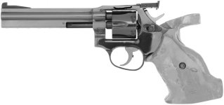

Maybe the better option would be a Manurhin Match 32. They have a cylinder specifically cut for target (wadcutter) ammo and are available with a traditional SA/DA action or a short action SAO. Available with 5" or 6" barrel. Latter weighs 2.37 lbs.
see pic.

The post from 6string brings this back to reality. While it would be very easy to retool the model 67 for 32 S&W or .32 H&R like the 16 -4 this probably is not something S&W would do.
