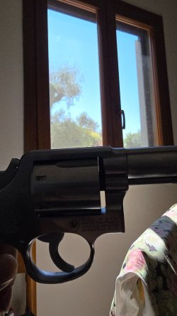

Almost no space (maybe 1mm) between cylinder and barrel. No shake at all, I can post some pics if necessary :)

1 mm is huge! Do you mean 1 thou? (0.001") You might look for crud under the extractor. That's a common cause for hard opening.
About that much of opening, a A4 paper will remain mostly "stuck" on that gap.

A4 paper is 0.004"-0.005", so that's perfect for barrel-cylinder gap. A little end shake is necessary for the smooth rotation of the cylinder when the cylinder is closed. Ideal end shake is 0.001" and 0.004" is maximum.
