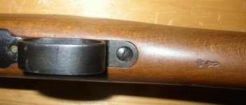

Stock apprear to be beech replacement (common for these rifles, I'm told) and has a single crown cartouche behind the trigger guard.

A few posters on other sites seem to think that all appears in order, but does anyone see anything out of place?

She's legit. The only problem, and it's a minor one, is the crown stamp on the stock. An m/41 or m/41B should have a Crown S stamp on the wrist for Stockholm Tygstation were the majority of these were built. Occasionally you'll see one with a Crown stamp with another letter donating another government arsenal, perhaps a stock replacement. The aluminum plate on the mount is a plus, it indicates the last time your sniper was worked over by an arsenal, 1972. I wouldn't sweat the crown stamp, perhaps Sven had a few too many Aquavits the night before and was being forgetful.
Thanks, sheepdawg! I converted a nice M96 (I know, I'm a terrible person) and noted that it has a crown O cartouche on the stock.
