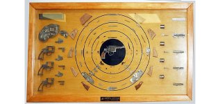

We have discussed this for a long time and the logical reason why stocks from other guns are never guaranteed to fit the next one is that both steel and wood were removed to obtain the perfect fit. Quality of this operation varied by the workman doing the job, their expertise, and experience. Also, remember that the forging was just that, a large chunk of steel that looked something like a frame. Lots of steel was ground off to get down to the proper measurements and did not change much since the first hand ejector was forged. Workmen were responsible for their own pieces of equipment and made their own jigs, fixtures, and gauges. Bottom line is that until the 1980s, no two finished frames were exactly the same.
Even in the 1950s, forgings looked nothing like the finished product.

This article from a 1950s Gun Digest is perhaps the best chronicle of the progression of the manufacture of S&W revolvers from billet to finished product. Look closely at the workmen and equipment to see what actually happens on the journey. Click on each page and then magnify to see all the details of the operations.
