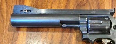

I have a Model 10-9 made September 1991. Pic attached. I absolutely love this wheel. The 10-9 is well balanced, accurate, and reliable. Although, whenever I see discussions about the 10 I always seem to notice a general preference for the bull barrel. Why is that? What does the bull barrel offer that my pencil barrel does not?

The heavy barrel is slightly more muzzle heavy, so that would help with muzzle rise during firing. Other than that, makes the Model 10 look like a Model 13 and that also meant only one fixed sight K-frame barrel and frame profile to produce, not two.

Better balance and stability for some people, especially when aiming seriously.
It is also possible that at some point in history, some folks, especially in LE, prefered the superiority of the heavy barrel as a bludgeon.
Myself, I pretty much prefer the pencil barrel for its lighter carry weight and for its quicker pointing, but the stability of the heavy barrel is not to be ignored.

I used a 10-8 for about three years when I was seriously shooting IDPA. The heavier barrel definitely helps with barrel flip when shooting +P-level loads (required back then to meet the power factor) fast. Other than that, some shooters just prefer the way a heavier barrel hangs when shooting.

The heavy barrels are just a bit more stable in most human hands; just more mass. I went from model 10 and 64 revolvers to a model 66, later to the heavier yet model 686. With the heavier revolvers, my qualification scores routinely picked up a point or two.
