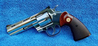

I only have a couple hundred rounds through my 4.25" new Python, but all have been 158gr. 357 magnums. No issues so far. Mine has a really smooth double action, and the single action is as good as most of my Smiths. I have replaced both sights with the Wilson Combat units, and the grips with ones from Deer Hollow. I'd say it is equal in quality to any of my Smiths.
