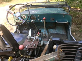

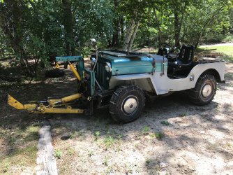

Mine was a 1946 CJ2.
I remember that one of its problems was the vacuum driven windshield wiper didn't work most of the time. (Note I said "wiper" not "wipers") I was stationed on the Gulf Coast at the time, so plenty of rain and found it easier to just fold the windshield down during a storm....
