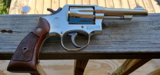

Local shop had a couple of early model 10s. One was half price of the other. Both nickel, one had a beautiful finish, the other was yellow and dull. The dull had that yellow sheen indicative of old WD40. I brought home the cheaper one. It was in excellent mechanical condition. I've cleaned a few of these WD40 guns, so I knew what to do. 45 minutes at the bench and I have gun now in better shape than the more expensive one! A little bit elbow grease goes a long way! My guess is somewhere around 61 or 62 model 10-5. Super slick action, older Smiths are really hard to beat.

Beautiful nickel on this one. I haven't come across a WD-40 sullied nickel S&W before. So how DO you remedy the yellowing situation?
Old WD40 is really tough to break down. In the past I have soaked them in WD40 (hair of the dog) for a day or so and washed them down alcohol or even ammonia. This time I used automatic transmission fluid, soaked for a 24 hrs (stocks removed) scrubbed it good and washed out with alcohol. Finished up with some Blue Magic metal polish (ran out of Flitz and this actually worked better). WD40 is the devil for firearms. I've bought them completely locked up gunsmith specials, degunked them and they operate perfectly. That yellow sheen tells the tale!
WD has been responsible for several "great buys" I have made over the years (mostly due to bound up internals). A good automotive varnish remover is effective for the internals, and a gentle round or two with Flitz for the external. I follow with a drop of Mobil 1 and a coat of Ren Wax respectively.

I cannot believe that the yellow showing on nickel plated guns is WD-40, since it would wipe away with one swipe of a cloth with acetone. WD-40 is composed of Aliphatic Hydrocarbon 65-75% and Petroleum Base Oil less than 35%. Both are easily dissolved in the presence of solvents. Nickel plating gives off a slight yellow cast when freshly supplied and can oxidize over time given the right circumstances. If left long enough, without protection, nickel oxidation reduces the shine and brightness of nickel. Polishing compounds are best used to bring back the brightness.
