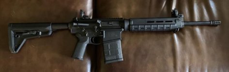

It's been magpulled quite a bit. My wife says it's done.
