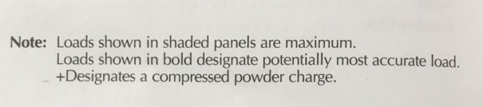

A compressed TrailBoss load from Lymans 49th.
460 S&W Magnum.
IIRC a fill to base of a 255gr lead is over 14gr and maybe 14.8gr... load data not handy.

My guess as to the accuracy of that load may be tied to it's velocity seeings as it is a plain based cast bullet.
Someone must have done some fancy calculating (or guesswork) and decided the mighty 460 could handle the pressure increase.
I have no doubt that it and the 500 can but it would be nice to know the actual facts behind the decision to publish that load.*
Modeling what happens to the burn characteristics when you crush a propellant is not exactly straightforward.
