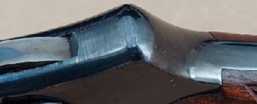

It all looked really good until this picture:
Up to that point it looked like the gun was just really really oily.
The area behind the hammer looks weird. But it could be a reflection of something.
Otherwise that gun looks really really good to me. I don't see signs of re-finish in other pictures.

The picture above and the one of the topstrap both look odd. I think they are both a combination of a reflection and the streaks left when wiping the gun down. Those kind of high polish finishes are very hard to get to look flawless. As outstanding gun in my opinion.
The gun looks 100% righteous to me. The funny looking area behind the hammer is most likely just streaking from the gun being wiped down.

And that's the photograph that made me question it as well. The finish is a little weaker here, but that's from being grasped with sweaty hands. I would have expected a better fit of the stock here, however.
I'm guessing the photographs and poor depiction of the blued finish is why it hammered lower than I thought it would, at $6025.
A photograph of the frame under the stocks would have proved helpful, ruling out the presence of a month and year code indicative of a return to the factory.

I think you are right, I bet that if they had taken one more photo of that area from another angle it would look fine.
Although, looking at it again the next day, the little dings along the edge of where the hammer is do seem slightly odd to me.
All of the side plate screws have been screwed/unscrewed with a screwdriver blade that was too long for the slot.
The blade tore up the edge of the sideplate itself in each instance.
Plus, the edge of the side plate where it meets the frame right underneath the cylinder,,,that long straight edge,,is upset with several burrs that have remained high. Those burrs or turned up metal have since had their bluing worn off and are now 'in the white..
There are some other signs of the same around the edges of the sideplate fit seam as well but that is the most noticeable area.
You can bring up that particular pic on the auction site and then go over the pic with the curser to enlarge the areas. It is easily seen at that point.

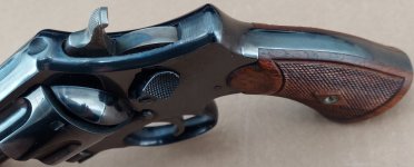

The pic of the butt and ser#. Look at the ends and the overall symmetry, or lack of it actually, in the what should be rounded ends of the back and front straps and the grip panels themselves.
Polished way off center from being an Oval shape of any kind. Not something I expect from that era.
Maybe just the picture playing optical games.

IMO, this gun is all original and righteous with one exception--
That spot behind the hammer has been hit with a very fine grinding wheel- probably a rubber abrasive wheel. Maybe it had a bad ding, or maybe someone removed his name or initials or a police evidence mark. It was touched up with cold blue. The sideplate was off the gun at the time, and you can see a tiny lip of sideplate showing above the frame.
Otherwise it is a pretty gun, but not NIB.

The hefty polish mark on the knuckle is something that's hard to overlook and then list the gun as NIB.
One thing about that large rough polish mark. Aside from why it may have been done...The gun had to have been reblued in order for that area to have the deep blue color it now has with the rough grind/polish beneath it.
How does that happen on an orig Factory blued finish.
Yes there are ways to spot in bluing, using rust blue and even hot blue for touch up.
But then we'd have a gun that's been reblued,,not orig factory finish.
Those multiple dents and dings on the muzzle still don't fit in with the otherwise pristine look, nor does the rounded and beat up front face of the front sight ramp.
Looks like it was used as nut&bolt sorter from that end. But the rest is near pristine. Why?
Don't things like that cause people to question stuff.
..and one more thing in the pic of the knuckle grind mark..take a look at the dings and dents on the frame on the LEFT side of the trigger.
I've seen cold blue touch ups on otherwise original factory finished guns and that is exactly what it looks like.
