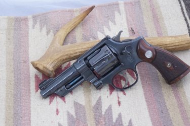

Sorry about that ...just reusing the only photo I had of the fished antler. The photo was teken from an earlier Reg Mag thread:
