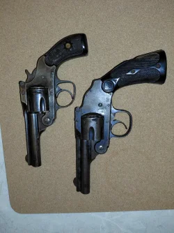

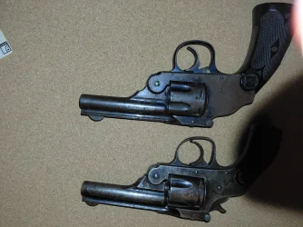

Old rev1.webpOldrev2.webpHi Folks I have two of my great-grandpa's top break revolvers.
I'm told they were issued to him as he was a conductor on the rail line from Wichita, KS to Pratt, KS for many years in the early 1900s.
The 6-shot hammerless one has "S&W 32 CTGE" on the barrel, the one with the hammer is a 5-shot and has no barrel markings, and is larger than 9mm bore in the cylinder. It does have "F&W" and a shield on the grips, but no other ID that I can find.
Any help in identifying them is appreciated. Prolly just paperweights, but they do have some family history.
TIA, John

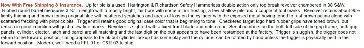

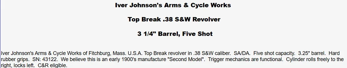

Below are two revolvers that are on auction for under $200 that appear to match yours
Harrington & Richardson (H&R) safety hammerless
Iver Johnson Top Break. Yours has an older style grip pattern, but I believe it is Iver Johnson. If you can post more pictures of the top break including any stamps on it we can help narrow it down.
Screenshot 2026-06-06 054204.webpScreenshot 2026-06-06 053033.webpScreenshot 2026-06-06 053053.webp

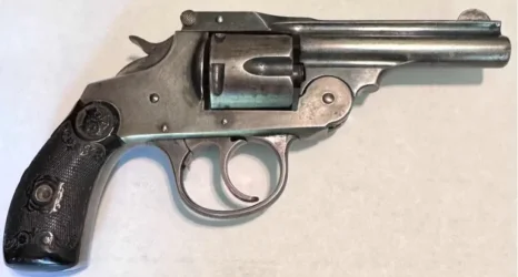

This one is a Forehand Arms Co. looks like a 32 Long 6 shot. These are worth a bit more than $200. Especially blued. Depends upon condition, action, markings. Should have Forehand Arms Co on top of the barrel and an 1887 patent date.
The H&R has Target grips. Those are worth some money but condition is everything. They look damaged on the back side. Too bad. They look like early target grips too! Those are scarce.
View attachment 881764View attachment 881765
View attachment 881770View attachment 881767View attachment 881768
Thanks Lark, I was able to ID the 5-shot .38 (see above) as an "F&W Pocket Revolver."
Still working on the hammerless .32.

Thanks, but the only thing on the barrel is ".32 S&W CTGE." (On the left side). I haven't yet taken the stocks off to see if an S/N appears there.
Interesting. The pistol with the H&R target grips might be a Spanish copy pistol that had the H&R target grips put on at some point. Looking at the H&R book by Bill Goforth, it seems the company never made a 6 shot 32. Their small frame hammerless top breaks in 32 were 5 shot. And their large frame hammerless top breaks were 5 shot seemed to all be in 38 S&W only.
H&R always had a company roll mark of some kind on the barrel top strap.
All this is just a guess on my part from the quick research I've done. And I'm no expert in European top break copies. Good luck on your continued search! And I hope I haven't muddied the waters!
All this is just a guess on my part from rhe quick research I've done. And I'm no expert in European top break copies. Good luck on your continued search! And I hope I haven't muddied the waters!
Thanks for the info. I cleaned the top strap a bit, and it does read:
"Harington & Richardson Arms Co"
"Worchester Mass USA"
I don't find any patent dates.
Definitely a 6-shooter in .32 S&W caliber.
These will just be "Mantle Pieces", I have no intention of firing them in their present condition.
Ahh, thanks for the info.
I read too quickly, and H&R did make a hammerless 6 shot in 32 S&W Long on their large frame yop break. My apologizes for the wrong information.
Checking Gorforth's H&R book, and reading your top strap markings, your pistol was made sometime between 1913-1915. Models before those dated contain some patents on the top strap. Models after that date range have the state of Massachusetts spelled out, instead of Mass.
