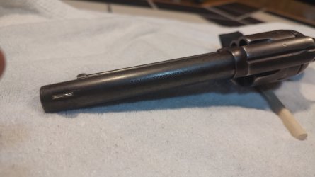

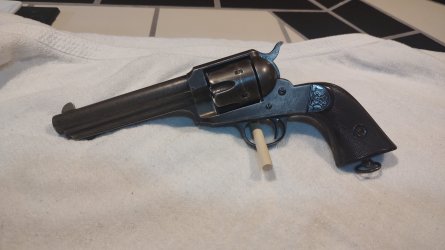

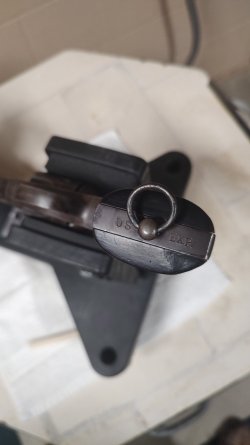

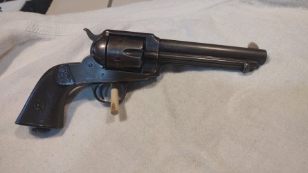

Thank you for the reply. Here are some photos. I have two corrections tho, yes 1894 production and 1168 serial not (78) . I did not have the gun in my hand at the time of the writing. Hopefully this will help identify your research as well

I am doing research on a Remington model 1890 ssa 44-40. What compelled me to purchase the gun were the letters stamped on the butt end of the grip strap. all capital block style antique letters. ( US EXP ). the gun was produced around 1904 serial number 1178.
some guys have told me to contact United States Express Trucking, they didn't exist then. Others said maybe it stands for us expert marksman in the military and was awarded to a person. it may be a fake express con job, but to me the stamping matches the patina and era of the gun pretty well. has there been any info on issuing a Remington handgun to an agent. I live near Ohio, Pa, and New York areas.

Before I comment on the markings can you tell us if the barrel address is Remington & Sons or Remington Arms Co?
Murph
Hi There,
Murph, if you enlarge the last pic of the Remington, you
will see the barrel markings. (i.e.: REMINGTON ARMS CO. ILION, N.Y.)

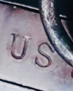

I have never seen or documented markings like this before. Therefore, I can’t confirm nor discount them. The font and deep stamp looks right to me.
However, I have to say in good conscience that I don’t like the cloudy appearance around the US stamp. I’ve seen this many times that “Normally” signifies a fresh stamp that was then pounded flat to appear old and that’s exactly what I’m seeing based solely on a photo. I’d have to see it in hand.
See attached photo.
The EXP. Also does not follow my research but honestly it’s still possible that it’s legit. Small contracts have oddities.

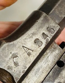

Lou,
Here is an excellent example of matching dies to prove markings. These are Remingtons also. Notice the unique C and very unique 3. And the long legged A. All the same on all 3 examples. That’s what starts the research. First by proving legit stamps.

Flip side:
See attached photo.
