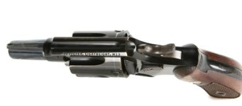

A local auction has this Aircrewman and several others but this one is only USAF marked, sn c283807 diamond grips P proof marke rates 95% no pouch, I noticed the grips has S&W medallion and was looking for USAF medallion, the 3 other model 13 are US marked, later S/N and a supposed pre model 13, which would be the pre model 12 with alum frame and cylinder, similar to my pre model 12. Marked revolver lightweight M13 all of them, no 2 C401708 98% US marked No 3. C402022 90% US marked No 4. C 402720 95% US marked. Pre model 13 ( pre model 12?) 2" airweight flat latch 5 screw diamond grips C237317 same as aircrewman but with out markings. On the USAF model, if the grip serial numbers match rest of gun, then I will consider this for a purchase, but the medallion grips send a red flag to me, please feel free to fill me on of legitimacy of these. Thanks Marc
was there a cut off s/n that the medallions were changed from S&W to USAF , also, there are extra model13 aircrewman parts available, cylinders, triggers, hammers and two sets of grips , this gentleman was a Retired USAF Colonel and this was from his personal estate,
seems like aircrewman 1948-52 US marked 1957 and pre model 13 ( model 12?) 1953 . why would pre model s/n date post date a dated aircrewman? red flag no 2?

The photos appear to show an authentic M13. I am unaware of how many (or early) of these had the Air Force stock medallions but they are not common. The serial number range of the guns mentioned all fall in the M13 range, and the US- and non-backstrap stamped guns are less common also. The only ways to tell if they are authentic are a factory historical letter and close in-person examination. Good luck with your decision.

great looking pistol!!! mine does not either, due to the transition model (1957-58) before the model was stamped in the crane. I have pics posted of it on other posts, I am confident that this was a factory set up, but letter will confirm this. I got mine from an estate auction from a retired USAF Officer. Now the only question I had was the high polished blue barrel and cylinder that seems different from others i have seen, but lighting conditions and clarity of photos make a difference too.

Marcus, I didn't mean to imply mine was ever a USAF gun. It's in the wrong serial number range. And I have a Roy Jinks ltr. stating it was sold in 1954 and to where it was sent and it's no AFB., so it's a civilian version with the aluminum cylinder, which was dropped from all of them at the end of 1954.
I think you are on to the "real thing", though.
