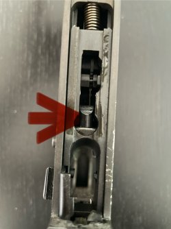

Thanks everyone for the suggestions, and sorry for not getting back sooner. After I posted, I put the gun away and didn't have time to mess with it, life got in the way.
Tried the suggestions last Thursday and still had issues. Even without the barrel, there was some friction. I checked the latch and saw it was slightly to the left, rubbing the frame. Once I centered it, it locked up smooth like butter.
Posting a pic in case it helps someone else. Glad I looked at it with a clear head, loving the gun again lol.IMG_9283.jpeg
