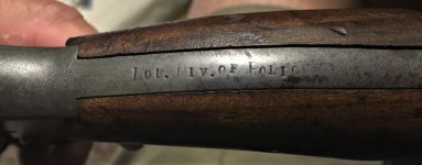

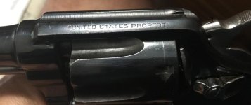

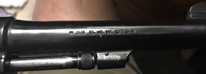

I would like to add my Victory models to the data base. I have two, the first is Brit lend lease in .38 S&W (.38/200) and is serial number V22177 with 5 inch barrel. It appears to have been delivered in 1942 and has United State Property on the topstrap. It appears to have been re-blued. The second is from a batch issued to the Louisville Police Department, .38 special, serial number V624138. It has Lou, Div. of Police on the backstrap and nothing on the topstrap, with a 4 inch barrel. It was delivered in June/July of 1944.

.....The second is from a batch issued to the Louisville Police Department, .38 special, serial number V624138. It has Lou, Div. of Police on the backstrap and nothing on the topstrap, with a 4 inch barrel. It was delivered in June/July of 1944.
A Louisville batch was actually shipped June 6, 1945. 400 guns to Chief Kimberling. I have V 626880. I lettered it and have a copy of the DSC invoice. I’m pretty sure yours would have been in that also.
According to Roy Jinks, the shipment apparently contained several guns with serials indicating production a year earler.
The Louisville Metro PD officer in charge of their museum was very surprised to hear the Chief ordered that many guns. I sent him the stuff I had, and he was going to look whether he could find anything in their files; haven’t heard back yet.

One thing I forgot to ask:
Does the Louisville gun have a matching serial on the right grip panel?
Mine has a noticable discoloration on the frame finish indicating it wore magna-shaped stocks for most of its service life, either S&W originals or Franzite-type aftermarket stuff which was all the rage in the 50s and 60s.
The stocks on mine now came from a late pre-Victory, so some dealer put them on later to “restore” the Victory to its original appearance.
The only other place I've found a serial number on the Louisville revolver is the rear of the cylinder. And thanks for the update on the delivery date.

Yes, the VM Database is very much alive and kicking. Thank you for your willingness to contribute your data. You can post the info here and I will be happy to give you any insights that the Database may offer.
We like to have barrel length, caliber, left top strap markings, any butt markings other than serial, finish, stocks type, and any post-factory markings. If you have any factory letter data that is also very helpful.
