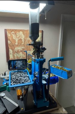

I do look into every case before seating a bullet, I also added a small scope to my dillon 650 that connects to my phone and shoots a image straight into the case along with a dillon powder check.

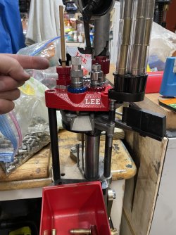

I totally agree with the double check. I use a Lee turret but, do not, use auto index. I will weigh case and primer together - insert primer and add powder - Re-weigh to verify charge - put that in the rack. When 50 rack is full then visually look into all to insure no doubles. Then insert bullet to depth and inspect for ripples or splits. I trust it.
