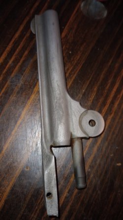

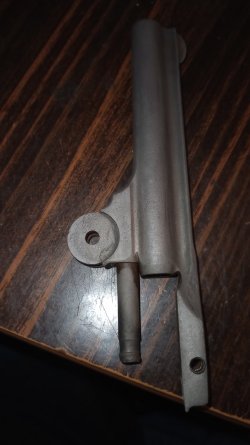

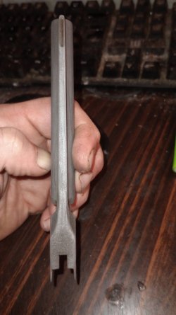

Hi, I have a s&w 2nd model .38 da barrel and cylinder. It's actually a first model I think, reissued 1871 patent date. Sn# are clearly 2nd model. Leftover parts I guess. Anyway some of the nickel was missing, very thick plating btw. I put it in my electroplating solution, just vinegar and salt and a piece of nickel and 6 volts. Done this many times to remove nickel. Anyway it removed the nickel, the patent date and the sn#. What the hell happened?

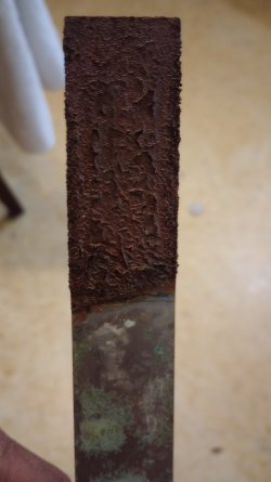

Im a dumbass. After looking at my nickel strip used in the deplating process, I have a heavy deposit of copper, under that a nice light blue depost telling me this thing was silver plated probably. It looked good when I polished it. It was black. After i polished it it looked good, just a little duller than the nickel on the frame. Why oh why didnt I leave it alone. Now I got a somewhat rough casting. Ugh
