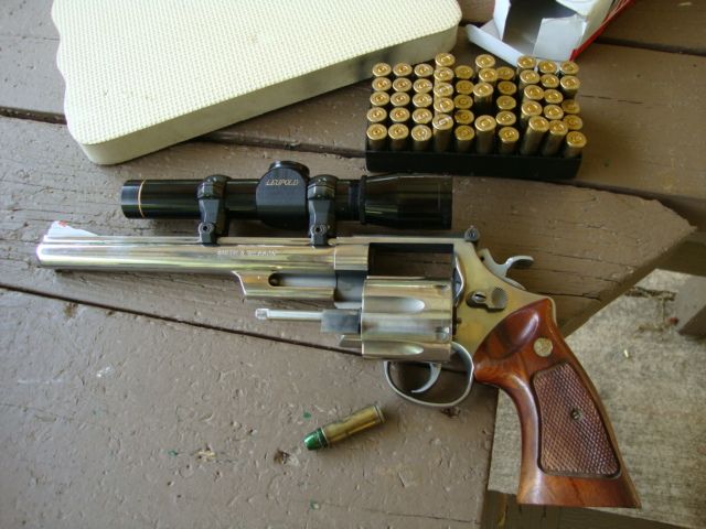

I shoot a 240 gr. cast bullet (straight WWs) with NO gas check out of my scoped 629 Classic using a max. load of 2400 powder. With a rest, I am getting 3/4" groups at 50 yards and no leading!

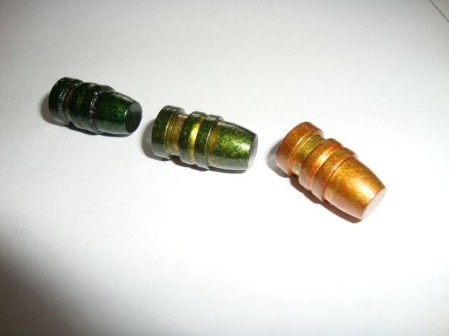

It's really quite the opposite. Most commercial cast bullets are too hard. Most are going to be BHN 16-18 or higher and for moderate loads (say 1000fps or less), you don't need more than 8-10.
Very true! I've even run coated 9-11 BHN bullets in front of healthy charges of H110 and 2400. Works well.
