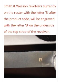

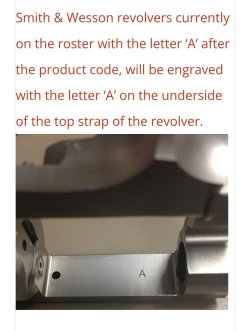

Model differences were needed due to the different drop test requirements some states have.
Google is wrong.
Smith and wesson had to make small differences in the models to be able to pass the drop testing. Like California.
Below: courtesy of the California DOJ. Roster of approved firearms.
