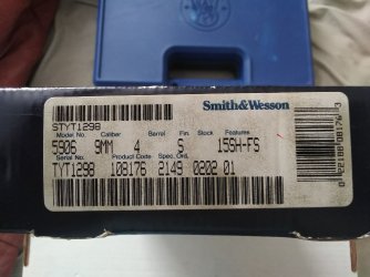

I bought a brand new 5906 with Novak sights and curved trigger guard in the early months of 1992. I recently sold a round trigger guard 5906 with a SPEC ORD of 2149 so 91-92 appears to be the 9mm transition.
