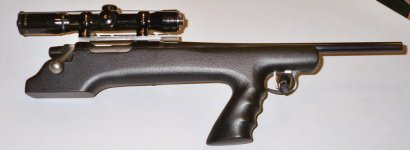

When I started shooting long range pistol in the early '90s, the Nosler Ballistic Tip was all that anyone would use. They were by far the most accurate bullet on the market. When I weighed them, I found that every bullet was spot on in weight with absolutely no deviation from bullet to bullet. Every 7mmBR bullet was 140.0 grains. Not sometimes 139.9 or 140.1, they were 140.0
In my Frank Glenn custom Remington XP-100, the Noslers would shoot to a little over one inch at 200 yards. And that was with the Remington factory barrel (a testament to how good the Remington XP-100 barrels were back then).
If you want accuracy, use the Nosler Ballistic Tip.
