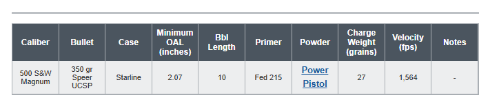

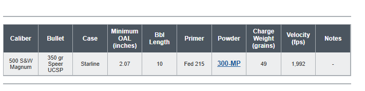

An example. Alliant has an online source of recipes for all of their powders, That is the safest place on the planet to find load data to start with and then create your own loads watching pressure data.
For example, if you go to the Alliant site and look at the 300 powder and the 500 SW, it only gives one load. That load is the safest source you will find.
If you prefer Power Pistol, they have a recipe too.
You get very different velocity all else being equal. But what you know is both of those recipes are going to be "safe". Both will be close to maximum loads.
And that is why the company that makes a powder, is the safest source of reloading data.
