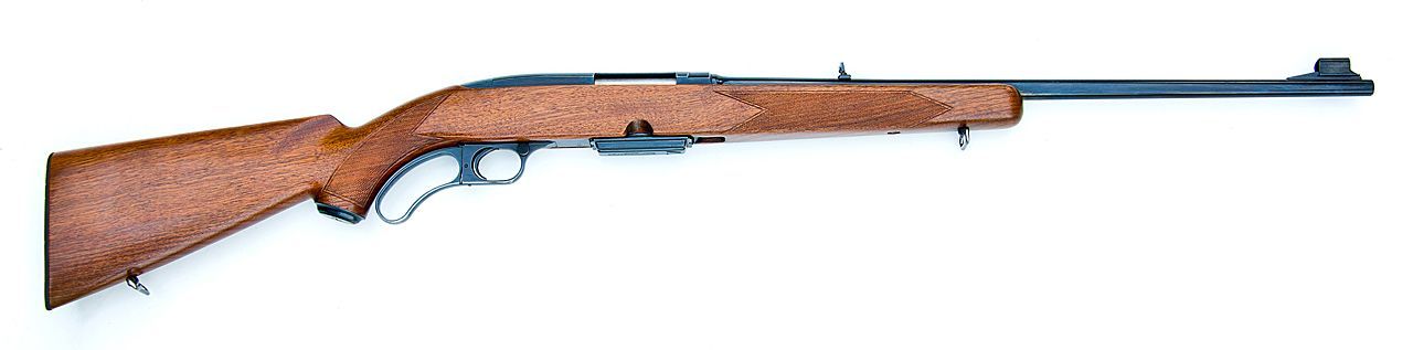

I saw this old fella at my local place that usually only has black plastic stuff. They had it marked at $500 but I whined it down to $350 plus background.
Metal good, wood bad.
They started making Model 88s in 1955, this one is from 1956.
It has a decent scope - Leupold M8 fixed 4 power, mounted low just how I like it. Its very clear.

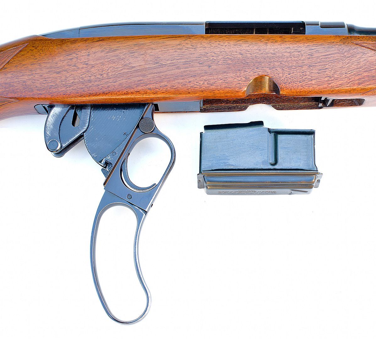

Apparently I got the only one with a good trigger, if the internet is to be believed. Very little take up, very little after-travel. Probably 4 pounds. The trigger travels with the lever, so I can understand how it might be tough to engineer a decent trigger pull. This one is fine, though.
The stock has had an adventurous life.
The pre-64s had actual checkering. Still looks ok there.
It still has the Winchester standard issue recoil multiplier.
Oh yeah, its a .308 which is fine with me.

Be aware of the pin that's in the lever right behind the trigger. They tend to work themselves out.
