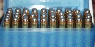

Here they are loaded in the 444 at velocities between 1700 and 2100 fps. using I-4227 and H-4198.
1750 is around what many 20" 44 magnum carbines will do.
I use these as plinkers and to practice working that lever gun with the peep sight.
I believe the shiny part at the front of the jacket is where the final swage was applied.
I would not hunt with this bullet at velocities over 1800 fps. as the terminal performance is unknown and suspect
