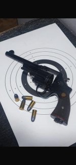

I was authorised my TL on a Sect 7.1 but opted to go 7.3 and shoot it
I reload my own ammo and gun shoots a treat

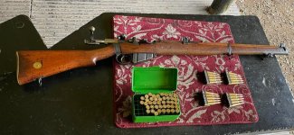

The revolver sits nice with my 1915 SMLE
