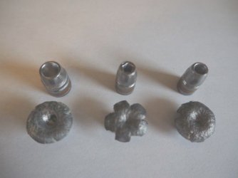

But to be honest, lead hardness is a problem. The matts bullets are supposedly 20:1 but pushed through a 6" barrel from a 38 special case, loaded with 13 grains of 2400 or 4227 as unle elmer and skeeter suggested,,,, i had no expansion at 20 yards into boards, rotting stump, mud, water jug.
Best I could get was crumpling of lead INTO the hollow point cavity, and chips.

I wanted to duplicate the infamous FBI 38 Special load for my revolver/rifle practice ammo. I used the Hornady 158gr lead SWC-HP with the knurled shank. I am loading them to 1000fps out or a 3" revolver and that gets 1400fps from the rifle. These bullets do NOT expand. The tumble and smush the hollow point over. what bullets are you using to get expansion? I may try a cast bullet instead of the swagged lead next time. I have had good performance from Matt's Bullets soft cast bullets in 44 and 45. I may see if their bullet will expand.

I see you say the Hornady is 'pointy', which tells me that's probably one reason it's not good on expansion. I'm not trying to negate or disagree your comment, just saying that what good is a hollow point that doen't expand? I'd expect something better out of a swaged bullet, being soft, but apparently the Hornady's only have a 'simulated' hollow point. I experimented with some hard cast HPSWCs one time that the HPs were obviously there for decoration because they looked as if they did everything they could NOT to expand. (In their defense they were heavy for caliber so I couldn't get the velocity, but I don't think it made much difference. ) Oh, another problem I can see with running swaged bullets in hot loads is possible leading. Probably not a big deal for defense use, but shooting them a lot in practice would probably lead the barrel.
I think I would tend to use a JHP and looking at the 'Lucky Gunner' tests a LOT of 158 gr. JHP bullets were no great shakes when it came to expansion and the Federal LSWCHP overpenetrated while the Remington's and Winchester's LSWCHP did pretty good. So it's a little tricky to get consistent performance. I guess that's why I prefer medium weight bullets that have reliable performance in penetration and expansion at the velocities they'll be used at. The good ones blow up to a half inch diameter or more.

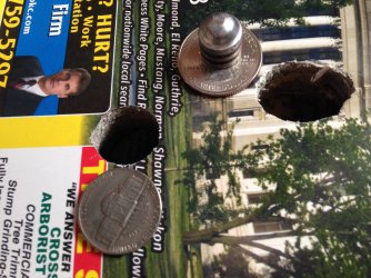

I agree, and that is why my EDC load for my .44 is a soft HBWC reversed at about 800-850 fps. Why you ask? I have personal experience of two persons shot with HBWC at the same velocities, only in 148 grain .357 size. Both were quick one shot stops and the coroner stated he had never seen such devastation for a handgun bullet. I feel my lite Loud Mouthed loads will get me home for another day. Just reporting, not arguing. To each their own, but I agree, USE what you have proven works. Later...
I shoot the Button nose WC turned backwards (45ACP) at target velocities in the military revolvers shoot. they punch perfect holes that can be scored from 25 yards. When asked what bullets I am shooting I answer Boat Tail Wadcutters.
