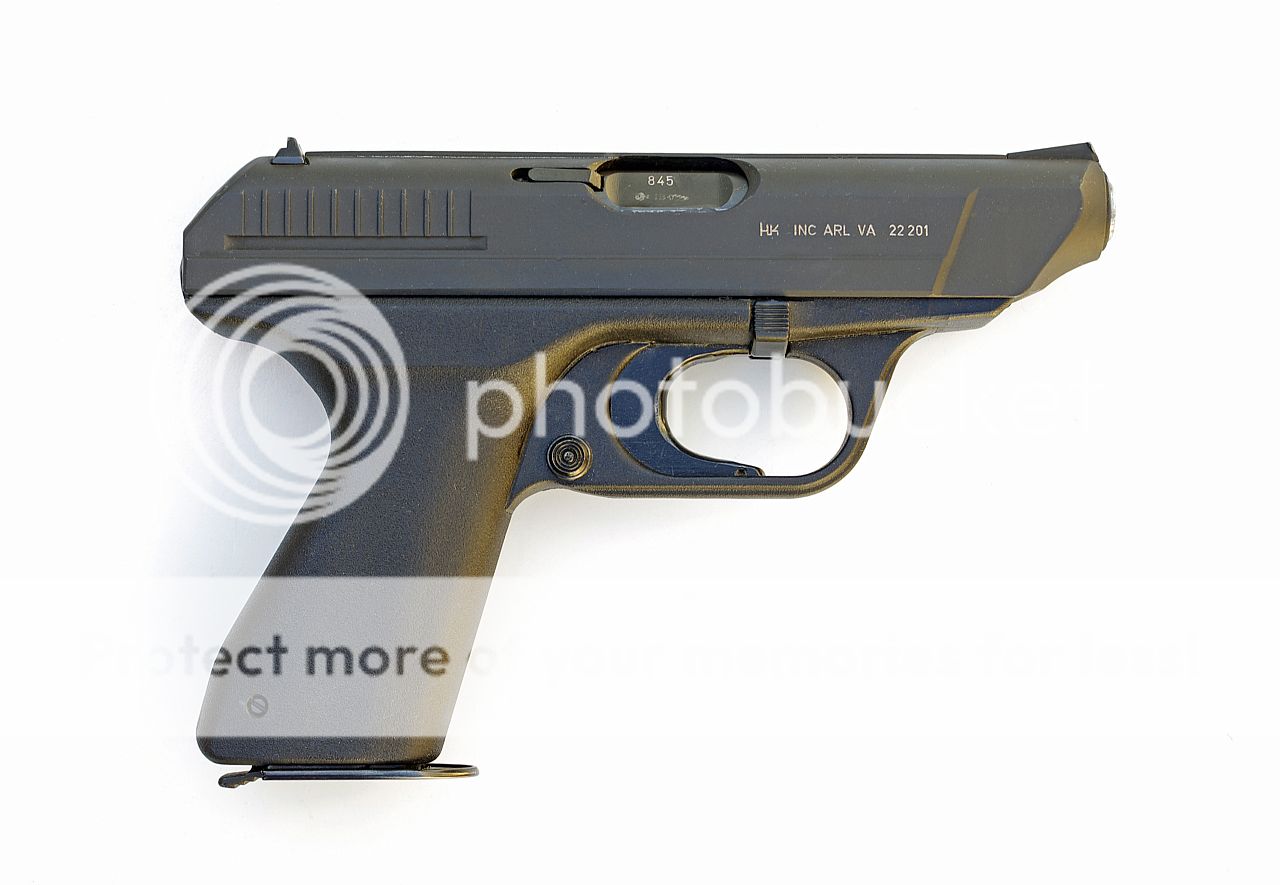

I prefer limiting the term to those systems that specifically do nothing but delay the blowback, and not include those that accomplish power management by additional means like locking the breech and redirecting the force vectors.
And just for some gun porn, here’s where I first learned about delayed blowback in the 1970s: the HK P9S.

Delayed blowback, aka retarded blowback, is a fine design used on some of my favorite pistols. They're typically very accurate because of the fixed barrels. The downside is the internals accumulate fouling quickly and require frequent cleaning. It's a much more complex design than a gun with just a heavy slide and recoil spring.
The H&K P7's are one. They vent gasses into a chamber to slow the rearward movement of the slide, via a piston. It's basically the opposite of a gas operated semi-auto.
My other favorite is the Steyr GB. I've got three of them now; a standard model shooter, a NIB standard model and a military model. I also have two of their muzzle breaks, which are fairly scarce, reduce recoil even further and add to the "cool factor". These have internal ports and piston rings on the barrel, that vent gasses between the barrel, slide and frame to keep the action closed until pressures drop.
Please ignore the Browning GP Competition, the Kimber and the Glock...
