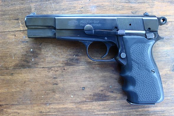

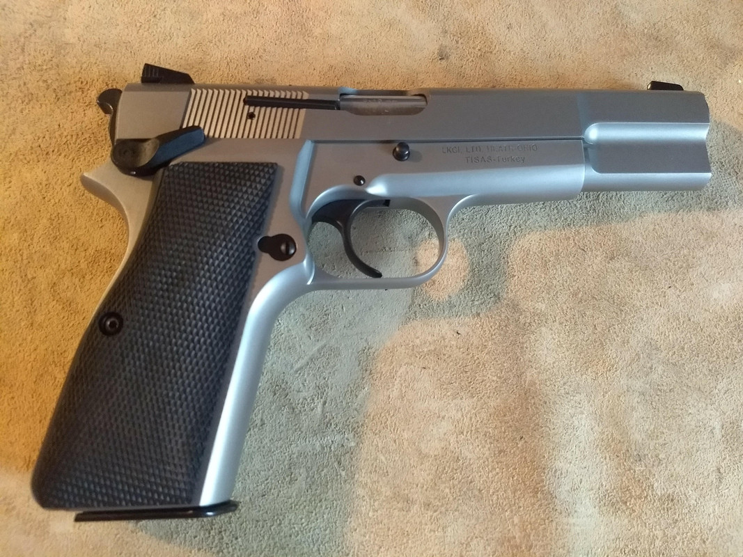

For example here is one of my KBI imported “Hi Power” pistols, a P9 with the larger 3 dot sights and extended safety lever from a P9M. I’m not complaining however, as I think it’s the best configuration for an FEG Hi Power.
Here’s a P9 with the small safety and sights (with non original Hogue grips that I almost immediately replaced):

Originally Posted by Sistema1927 View Post
Best HP grips ever, and I like the SFS as well. I have it in both my FN and my Tisas.
My FN SFS Hi Power came that way from the factory and I got it dirt cheap when FN discontinued them.
I also converted one of my FEG 1st Gen P9M pistols to SFS operation. I did the conversion after an armorer friend of mine did a trigger job on it, and removed a bit too much metal, getting under face hardened surface on the hammer and sear and into the softer metal underneath.
Rather than install traditional replacement parts from
FN or Cylinder and Slide, I got FN SFS parts from cylinder and slide and installed them instead.
The fire control parts fit just fine with only a normal amount of hand fitting. The slide release lever is optional as it’s just a cosmetic change.
However I opted to use it on my FEG, with its smaller 1911 style slide cut.
The smaller cut required some re-profiling of the of the slide release lever.
