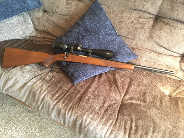

Originally Posted by Sistema1927 View Post
A few years ago I realized that I didn't have a truly accurate .22 rifle in my safe. I purchased a Savage Mk-II FVT. The synthetic stock was terrible, so I put it in the Boyd in this picture.
Have a Mk-IIFV-SR, and it's gotta be the the best deal for accuracy currently owned. One of theses days may put a scope on the CZ-452 to compare the two. Fortunately the short stock fit's me.
