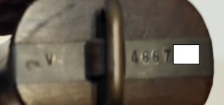

I finally scored a decent Victory! :) .38 Special, serial number appears to place it in 1943; matching serial numbers on butt, cylinder, barrel, and right stock. It has the 'P' proof marks on the left side of frame above and to the right of the cylinder window, also on the cylinder and barrel. Flaming bomb to the left of the 'V' in the serial number. No government property markings or inspectors initials so I assume it was a DSC gun. Phosphate finish except that the ejector rod looks like it might be blued. Superb mechanical condition, bore is bright with sharp rifling. Hoping to get to the range next week. Hemming and hawing on whether I want to cough up $100 to get it lettered...

Looks to be a nice original example. For what it's worth, V464092 shipped in February of 1944. while V490378 shipped in January of 1944. Yours likely went out the door somewhere in that time frame.
